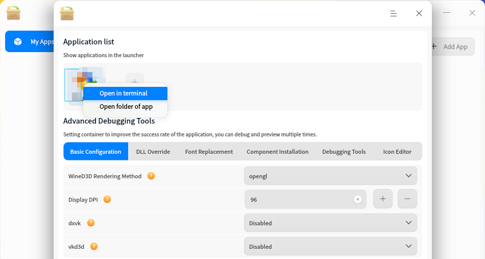

1.2 Check Error log
If you find that the program cannot start, you can try the following methods to troubleshoot whether the 32-bit graphics card driver is missing
Click "..." next to the program icon, select "Advanced Debugging Tools"
right-click the program icon in the pop-up window, and select "Run in End Point".
If there is a failure to load files under the /lib/i386-linux-gnu/ path in the error log, it means that the 32-bit graphics card driver is missing
  • For example:
libGL error: MESA-LOADER: failed to open radeonsi: /usr/lib/pressure-vessel/overrides/lib/i386-linux-gnu/dri/radeonsi_dri.so: cannot open shared object file: No such file or directory (search paths /usr/lib/pressure-vessel/overrides/lib/x86_64-linux-gnu/dri:/usr/lib/pressure-vessel/overrides/lib/i386-linux-gnu/dri)
libGL error: failed to load driver: radeonsi
