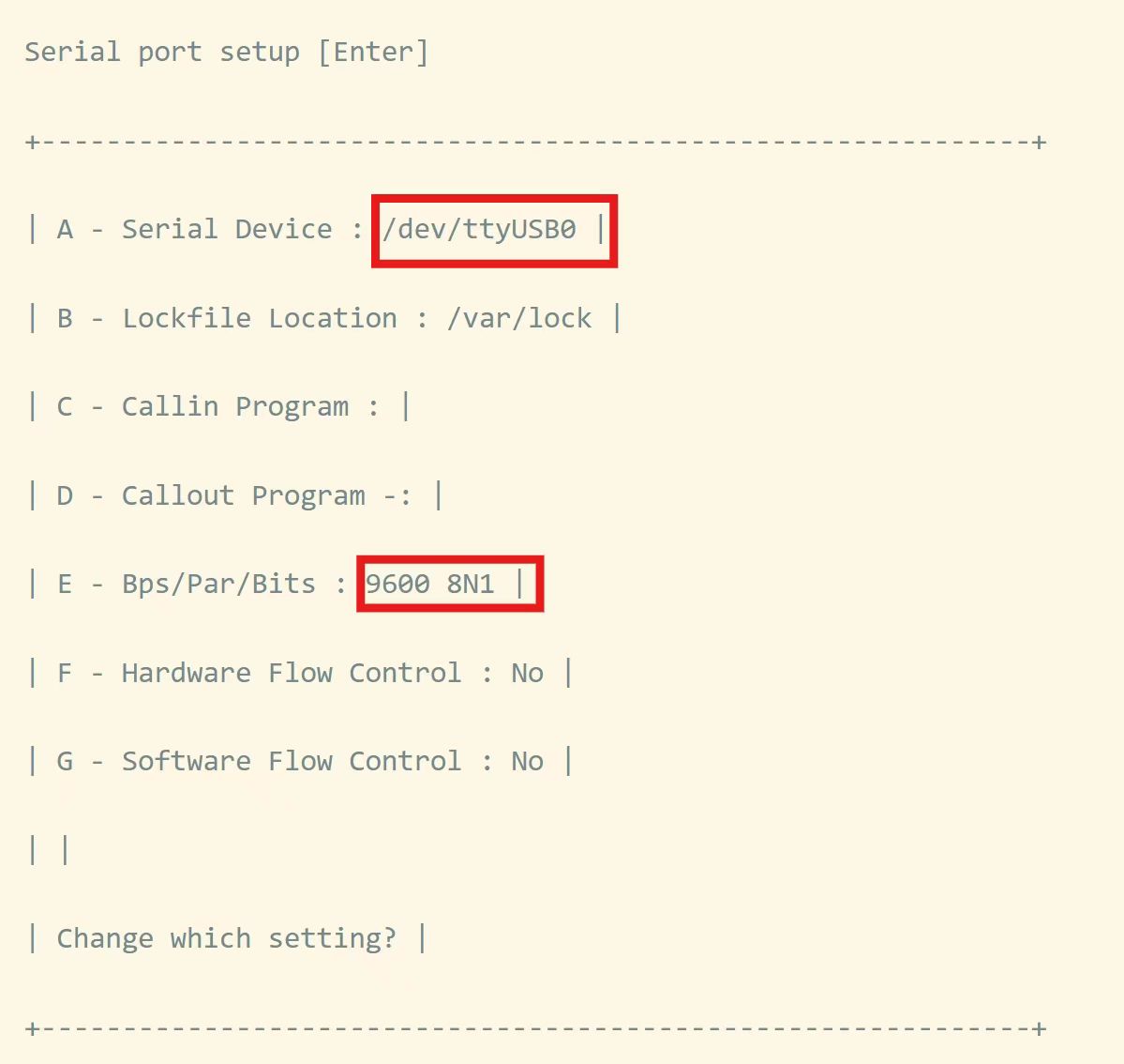

a. Start Minicom's configuration tool by entering sudo minicom -s in the terminal. This will open Minicom's configuration menu.
b. Select "Serial port setup" to configure the serial port. You will need to set the correct serial port device (e.g., /dev/ttyS0, /dev/ttyUSB0), baud rate, data bits, stop bits, and other parameters.
c. After configuration, select "Save setup as dfl" to save the default settings, and then exit the configuration menu.

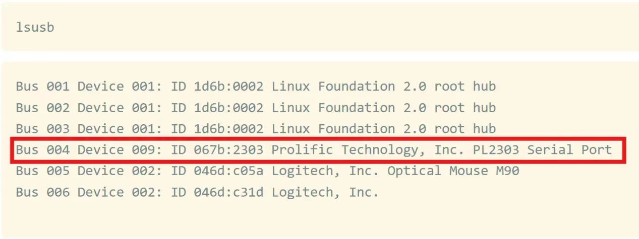

Before using Minicom, make sure you have sufficient permissions to access the specified serial port device. Typically, these device files are located in the /dev/ directory, and root permissions are required to access them. You can check the driver installation as follows:
lsusb # Check if the serial line driver is installed properly. deepin has it installed by default.
cd /dev # Enter the dev directoryls#
Check if the driver for ttyUSB0 exists in the dev directory

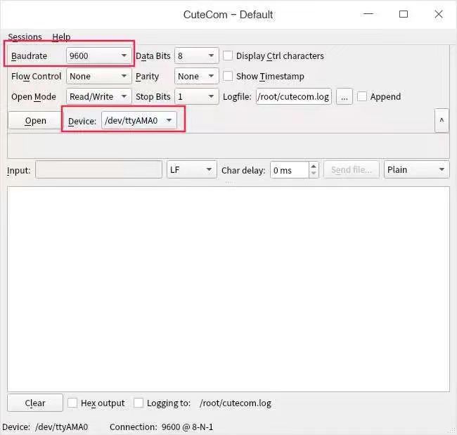

1、Start Cutecom: After installation, you can start Cutecom by typing sudo cutecom in the terminal. Since Cutecom may need to access serial port devices, you may need to use sudo to gain the necessary permissions.
1、Configure Serial Port Parameters:
a. Find the serial port: Connect your serial device to the computer, and then enter dmesg | grep ttyS (for traditional serial devices) or dmesg | grep ttyUSB (for USB-to-serial devices) in the terminal to find the corresponding serial port name (e.g., /dev/ttyS0, /dev/ttyUSB0, etc.).
b. Set serial port parameters: In the Cutecom interface, click the "Settings" button to enter the settings window. Set the correct serial port name, baud rate, data bits, stop bits, etc. Typically, the baud rate should be set according to your device's manual.
Note: At the top of the window, you can see widgets where you can adjust the serial communication settings. Below this section is the output view, where all the data returned by the device is displayed, including non-printable characters. At the bottom, you can see the input area, where you can input commands using the input line, along with a list showing the history of the input lines.
3、Connect the Serial Device:
Select the serial port: In the "Device" field of Cutecom, choose the serial port name you found using the dmesg command, or manually enter the name.
Open the serial port: Click the "Open Device" button in the upper left corner of the software to connect to the serial device.
4、Send and Receive Data: Once connected, you can send and receive data through Cutecom's interface. Typically, the interface is divided into two windows—the top window displays the received data, and the bottom window is used for inputting data to send.
5、Close the Connection: When you finish serial communication, click the "Close Device" button in the upper left corner of the software to close the current serial connection.
